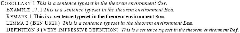

\newtheorem
You can say \newtheorem {X}{Y} or \newtheorem {X}[Z}{Y} or \newtheorem {X}{Y}[T}. This defines an environment X, labeled Y. In the second case, it uses the counter Z, otherwise it uses X as counter. In the last case, the counter is reset whenever T changes and the value of T is prepended to the value of X.
There is a command \theoremstyle that takes an argument, and remembers it; each theorem can see the value that was active at the definition. In the first case shown below, and in the preview, this value is ignored.
There is a command \theorembodyfont that takes an argument, and remembers it; each theorem uses this value as font for the body.
There is a command \theoremheaderfont that takes an argument, and remembers it; each theorem uses this value as font for the body. For some strange reason, this quantity is global (should be used only once). Example.
\theorembodyfont{\sl}
\theoremstyle{break}
\newtheorem{Cor}{Corollary}
\theoremstyle{plain}
\setcounter{section}{17}
\newtheorem{Exa}{Example}[section]
{\theorembodyfont{\rmfamily}\newtheorem{Rem}{Remark}}
\theoremstyle{marginbreak}
\newtheorem{Lem}[Cor]{lemma}
\theoremstyle{change}
\theorembodyfont{\small\itshape} \newtheorem{Def}[Cor]{Definition}
\theoremheaderfont{\scshape}
\def\Lenv#1{\texttt{#1}}
\begin{Cor}
 This is a sentence typeset in the theorem environment \Lenv{Cor}.
\end{Cor}
\begin{Exa}
 This is a sentence typeset in the theorem environment \Lenv{Exa}.
\end{Exa}
\begin{Rem}
 This is a sentence typeset in the theorem environment \Lenv{Rem}.
\end{Rem}
\begin{Lem}[Ben User]
 This is a sentence typeset in the theorem environment \Lenv{Lem}.
\end{Lem}
\begin{Def}[Very Impressive definition]
 This is a sentence typeset in the theorem environment \Lenv{Def}.
\end{Def}
The translation is the following.
<p id-text='1' id='uid1'>
 <hi rend='sc'>Corollary 1 </hi>
 <hi rend='slanted'>This is a sentence typeset in the theorem environment </hi>
 <hi rend='slanted'><hi rend='tt'>Cor</hi></hi><hi rend='slanted'>.</hi>
</p>
<p id-text='17.1' id='uid2'>
 <hi rend='sc'>Example 17.1 </hi>
 <hi rend='slanted'><hi rend='tt'>Exa</hi></hi>
</p>
<p id-text='1' id='uid3'>
 <hi rend='sc'>Remark 1 </hi>
 <hi rend='tt'>Rem</hi>.
</p>
<p id-text='2' id='uid4'>
 <hi rend='sc'>lemma 2 (Ben User) </hi>
 <hi rend='slanted'>
 <hi rend='slanted'><hi rend='tt'>Lem</hi></hi>
</p>
<p id-text='3' id='uid5'>
 <hi rend='sc'>Definition 3 (Very Impressive definition) </hi>
 <hi rend='small1'></hi>
 <hi rend='small1'>
   <hi rend='it'>
theorem}     This is a sentence typeset in the theorem environment
   </hi>
 </hi>
 <hi rend='small1'><hi rend='it'><hi rend='tt'>Def</hi></hi></hi>
 <hi rend='small1'><hi rend='it'>.</hi></hi>
</p>
The preview is the following
theorems
Note that the theorem counter is incremented via a call to \refstepcounter, in fact to \stepcounter plus the internal code that defines a label. In this case, the label is put on an anonymous XML element, then copied to the <p> element. If the configuration file contains xml_xtheorem_name = "dummy", then the name will be `dummy', and the result of the translation will be
<dummy id-text='1' id='uid3'>
 <p>
  <hi Rend='sc'>Remark 1 </hi>
  <hi Rend='tt'>Rem</hi>.
 </p>
</dummy>
If the configuration file contains xml_theorem_name = "theorem", then the name will be `theorem', and the translation is a bit different, as you can see.
<theorem style='break' type='Cor' id-text='1'  id='uid1'>
<head>Corollary</head>
<p>This is a sentence typeset in the theorem environment <hi Rend='tt'>Cor</hi>.
</p>
</theorem>
<theorem style='plain'  type='Exa'  id-text='17.1' id='uid2'>
<head>Example</head>
<p>This is a sentence typeset in the theorem environment <hi Rend='tt'>Exa</hi>.
</p>
</theorem>
<theorem style='plain' type='Rem'  id-text='1' id='uid3'>
<head>Remark</head>
<p>This is a sentence typeset in the theorem environment <hi Rend='tt'>Rem</hi>.
</p>
</theorem>
<theorem style='marginbreak'  type='Lem'  id-text='2' id='uid4'>
<head>lemma</head>
<alt_head>Ben User</alt_head>
<p>This is a sentence typeset in the theorem environment <hi Rend='tt'>Lem</hi>.
</p>
</theorem>
<theorem style='change' type='Def'  id-text='3' id='uid5'>
<head>Definition</head>
<alt_head>Very Impressive definition</alt_head>
<p>This is a sentence typeset in the theorem environment <hi Rend='tt'>Def</hi>.
</p>
</theorem>
