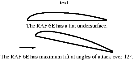

This is an example explaining \scaleput. The image appear in latex companion, first edition, page 291-292, but the numbers are taken from the documentation of the curves package.
\newcommand{\RAFsixE}{
  \scaleput(1.25,1.25){\arc(0,-1.25){-135}}
  \scaleput(0,0){\curve(0.366,2.133, 1.25,3.19, 2.5,4.42,
    5.0,6.10, 7.5,7.24, 10,8.09, 15,9.28, 20,9.90, 30,10.3,
    40,10.22, 50,9.80, 60,8.98, 70,7.70, 80,5.91, 90,3.79,
    95,2.58, 99.24,1.52)}
  \scaleput(99.24,0.76){\arc(0,-0.76){180}}
  \scaleput(0,0){\curve(1.25,0, 99.24,0)}
\setlength{\unitlength}{.5mm}
\linethickness{0.7mm}
\begin{center}
text\\
  \begin{picture}(100,20)
    \RAFsixE
  \end{picture}
  \\The RAF 6E has a flat undersurface.
  \begin{picture}(120,30)(-20,0)
  \renewcommand{\xscale}{0.9781}
  \renewcommand{\xscaley}{0.2079}
  \renewcommand{\yscale}{0.9781}
  \renewcommand{\yscalex}{-0.2079}
  \put(0,20){\RAFsixE}
  \thicklines
  \put(-20,5){\vector(1,0){20}}
  \end{picture}
  The RAF 6E has maximum lift at angles of attack over 12$^\circ$.
  \end{center}
Translation
<pic-linethickness size='0.7mm'/>
<p rend='center'>text</p>
<p rend='center'>
 <picture width='142.26227' height='28.45245'>
  <pic-scaleput xpos='1.77827' ypos='1.77827' xscale='1.0' yscale='1.0' xscaley='0.0' yscalex='0.0'>
   <pic-arc angle='-135' xpos='0' ypos='-1.77827' unit-length='1.42262'>
   </pic-arc>
  </pic-scaleput>
  <pic-scaleput xpos='0' ypos='0' xscale='1.0' yscale='1.0' xscaley='0.0' yscalex='0.0'>
    <pic-curve unit-length='1.42262'>0.366,2.133, 1.25,3.19, 2.5,4.42,
      95,2.58, 99.24,1.52</pic-curve>
  </pic-scaleput>
  <pic-scaleput xpos='141.18108' ypos='1.08118' xscale='1.0' yscale='1.0' xscaley='0.0' yscalex='0.0'>
    <pic-arc angle='180' xpos='0' ypos='-1.08118' unit-length='1.42262'></pic-arc>
  </pic-scaleput>
    <pic-curve unit-length='1.42262'>1.25,0, 99.24,0</pic-curve>
  </pic-scaleput>
 </picture>
</p>
<p rend='center'>The RAF 6E has a flat undersurface.</p>
<p rend='center'>
 <picture xpos='-28.45245' ypos='0' width='170.71472' height='42.67868'>
  <pic-put xpos='0' ypos='28.45245'>
    <pic-scaleput xpos='1.77827' ypos='1.77827' xscale='0.9781'
            yscale='0.9781' xscaley='0.2079' yscalex='-0.2079'>
     </pic-arc>
    </pic-scaleput>
    <pic-scaleput xpos='0' ypos='0' xscale='0.9781' yscale='0.9781' xscaley='0.2079' yscalex='-0.2079'>
    </pic-scaleput>
    <pic-scaleput xpos='141.18108' ypos='1.08118' xscale='0.9781'
      </pic-arc>
    </pic-scaleput>
    </pic-scaleput>
   </pic-put>
   <pic-thicklines/>
   <pic-put xpos='-28.45245' ypos='7.11311'>
     <pic-vector xdir='1' ydir='0' width='28.45245'/>
   </pic-put>
  </picture>
</p>
<p rend='center'>The RAF 6E has maximum lift at angles of attack over
    12<formula type='inline'><math xmlns='http://www.w3.org/1998/Math/MathML'>
          <msup><mrow></mrow> <mo>&SmallCircle;</mo> </msup>
        </math>
      </formula>.
</p>
RAF6E airfoil

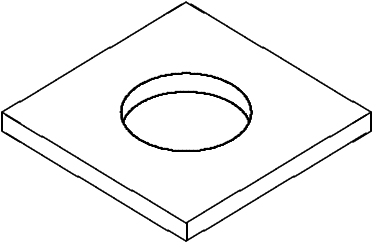

Last example, showing arcs and circles.
\setlength{\unitlength}{1.8mm}
\begin{picture}(40,30)
  \thicklines
  \multiput(20,5)(20,12){2} {\line(0,-1){2}\line(-5,3){20}}
  \multiput(20,5)(-20,12){2} {\line(5,3){20}}
  \put(20,3){\line(5,3){20}}
  \put(20,3){\line(-5,3){20}}
  \put(0,15){\line(0,1){2}}
  \linethickness{1pt}
  \put(20,5) {
   \renewcommand{\xscale}{1}
   \renewcommand{\xscaley}{-1}
   \renewcommand{\yscale}{0.6}
   \renewcommand{\yscalex}{0.6}
   \scaleput(10,10){\bigcircle{10}}
   \put(0,-2){%
      \scaleput(10,10){\arc(5,0){121}}
      \scaleput(10,10){\arc(5,0){-31}}}}
\end{picture}
<picture width='204.85962' height='153.64471'>
  <pic-thicklines/>
  <pic-multiput xpos='102.42981' ypos='25.60745' repeat='2' dx='102.42981' dy='61.45789'>
    <pic-line xdir='0' ydir='-1' width='10.24298'/>
    <pic-line xdir='-5' ydir='3' width='102.42981'/>
  </pic-multiput>
  <pic-multiput xpos='102.42981' ypos='25.60745' repeat='2' dx='-102.42981' dy='61.45789'>
    <pic-line xdir='5' ydir='3' width='102.42981'/>
  </pic-multiput>
  <pic-put xpos='102.42981' ypos='15.36447'>
  </pic-put>
  </pic-put>
  <pic-put xpos='0' ypos='76.82236'>
    <pic-line xdir='0' ydir='1' width='10.24298'/>
  </pic-put>
  <pic-linethickness size='1pt'/>
  <pic-put xpos='102.42981' ypos='25.60745'>
    <pic-scaleput xpos='51.2149' ypos='51.2149' xscale='1' yscale='0.6' xscaley='-1' yscalex='0.6'>
      <pic-bigcircle size='10' unit-length='5.12149'></pic-bigcircle>
    </pic-scaleput>
    <pic-put xpos='0' ypos='-10.24298'>
        <pic-arc angle='121' xpos='25.60745' ypos='0' unit-length='5.12149'>
        </pic-arc>
      </pic-scaleput>
        <pic-arc angle='-31' xpos='25.60745' ypos='0' unit-length='5.12149'>
        </pic-arc>
      </pic-scaleput>
    </pic-put>
  </pic-put>
</picture>
square washer
