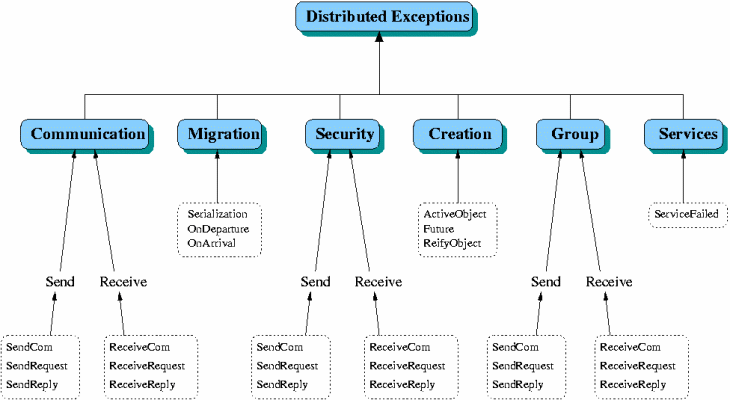

A few years ago, Aspect-oriented Programming first defined non-functional properties (security, persistence, transaction...) to produce separation of concerns (for information and more, see AspectJ website). Distribution is considered as a non-functional property, especially in ProActive where distributed mechanisms are transparent. Unfortunately, exceptions related to distribution are often raised from non-functional levels (i.e. network, Java RMI or JVM) and propagated to functional one (application code). But users do not have to deal with exceptions not related to the application. Such exceptions, raised from non-functional properties, are called non-functional exceptions and should not be propagated to the application. The handlers mechanism of ProActive is the result of intensive work presentes in a EHOOS'03 (ECOOP Workshop) article here.
Non-functional exceptions signal abnormal behaviour of non-functional properties (ie. distribution). They are gathered into a hierarchy based on inheritance. This classification is used by the handling mechanism (look forward).
Figure 1 : Hierarchy of Non-Functional Exceptions for Distribution
Distributed exceptions can be found in the following packages :
  • Communication exceptions : org.objectweb.proactive.core.exceptions.communication
  • Creation exceptions : org.objectweb.proactive.core.exceptions.creation
  • Group exceptions : org.objectweb.proactive.core.exceptions.group
  • Migration exceptions : org.objectweb.proactive.core.exceptions.migration
  • Security exceptions : org.objectweb.proactive.core.exceptions.security
  • Service exceptions : org.objectweb.proactive.core.exceptions.service

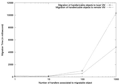

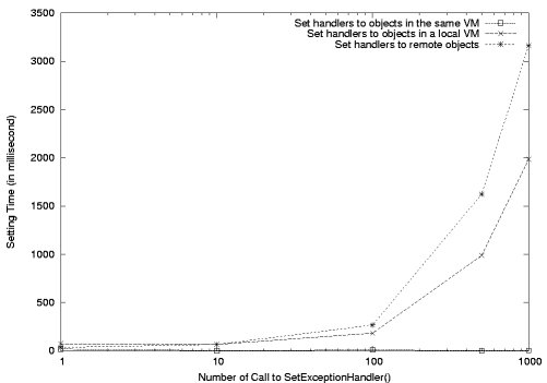

  •  Performances
    We made several tests showing that the mechanism remains light for the application. Overall performance are not affected by the configuration of hundred handlers or less. And that number of handlers is huge ! Moreover, configuration is a punctual operation. Mobility is not really affected until the migration of an object with hundred handlers. Both results show that every handlerizable object supports a few dozen of handlers with no other problem than a limitation to hundred handlers.
    Figure 2 : Performances of mechanism configuration
    Figure 3 : Performances of mechanism during migration
