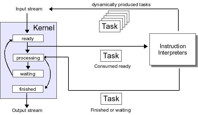

Problems inputed into the framework are treated as tasks. The tasks are interpreted by the remote skeleton interpreters as shown in the following Figure:
