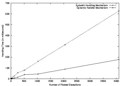

    Figure 1: Comparison Between try-catch-finally and NFE Mechanism

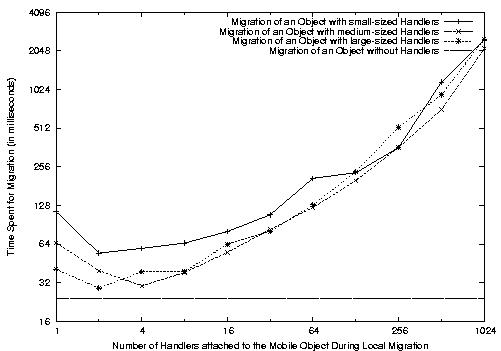

    Figure 3: Performances of Protected Local Migration

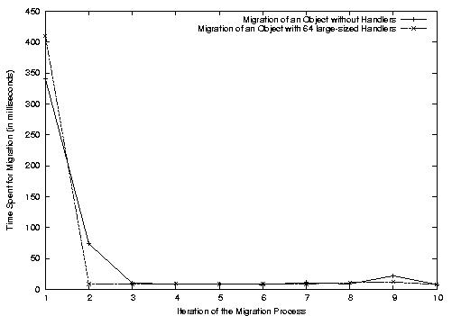

    Figure 5: Evolution of Migration Speed, iteration after iteration

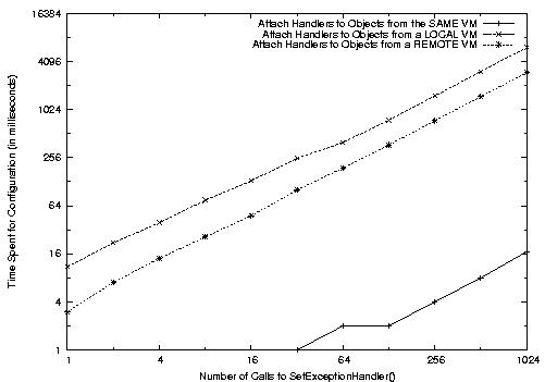

    Figure 2: NFE Configuration

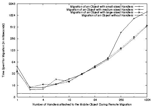

    Figure 4: Performances of Protected Remote Migration

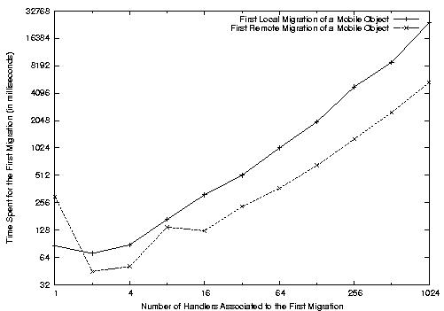

    Figure 6: First Migration According to Number of Handlers
