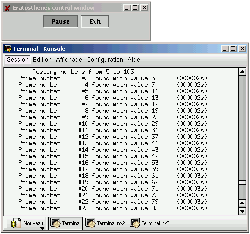

The parameter -nogui
starts the
calculation immediately without opening a control window.
The control window has two buttons:
ActivePrimeContainers
they continue their work until they run out of input.Prime number output is done on the console where you started the application, or on the node where the ConsolePrimeOutputListener is located if you migrated it.

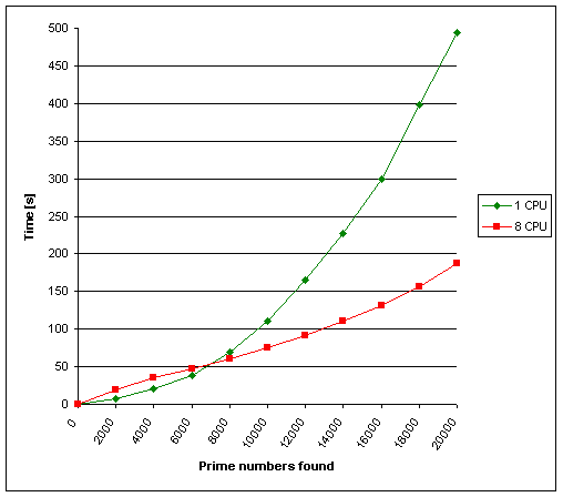

new prime number to the consoleTo make a basic test about the influence of distributed calculation, the program was run in a cluster environment with two different settings:
The time needed to find a certain number of prime numbers is shown below:
Prime number found | Value | Time: 1 CPU |
Time: 8 CPU |
2000th | 7919 | 7s | 19s |
10000th | 104729 | 111s | 75s |
20000th | 224737 | 494s | 187s |
The difference between the single CPU and the multiple CPU setting shows the cost of inter-JVM-communication. With increasing numbers the distributed calculation profits from its CPU power, although the communication between the machines has to be done.
