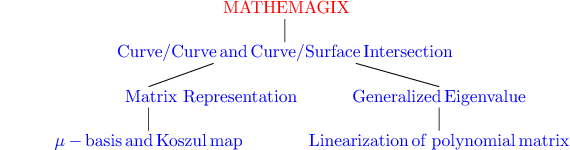

1.Introduction
Computing the intersection between algebraic varieties is a fundamental task in Computer Aided Geometric Design. Several methods and approaches have been developed for that purpose. Some of them are based on matrix representations of the objects that allow to transform the computation of the intersection locus into generalized eigencomputations . The aim of our works is to compute the matrix representation of these objects and to show that similar algorithms can be implemented even if the matrix representation used are non square matrices. Notice that recent researches, known under the name of the moving lines, moving surfaces, -basis method, have demonstrated that these non square representation matrices are much easier to compute than square representation matrices. In particular, the matrix representation of rational space curves are always non-square matrices
The approach to the curve/curve, curve/surface intersection problem that we develop in our works contain two main parts. The first one is the computation of a matrix representation of the curve and surface from theirs parametrization. This work requires advanced concepts of commutative algebra and algebraic Geometry such as: Elimination theory, free resolution of modules, Koszul complex, approximate complex, Fitting invariant, MacRae invariant, algebraic variety, primary decomposition of ideal,....One of the most effective algorithm for computing them is via Grobner basis of modules, Grobner basis of ideals or via -basis of a set polynomial. All of this computings are symbolic computations.
After combining this matrix representation of the curve and the surface with the parameterization of the curve, the second part consists of a matrix reduction and some eigenvalue computations. In this part, we use the technics of linear algebra such as: Kronecker form of a pencil matrix, Smith form of univariate polynomial matrix, LU-decomposition, QR-decomposition, Sylvester matrix, Bezout matrix,.... As a particularity of our method, these two parts can be performed either by symbolic exact computations or by numerical approached computations. However, it seems that a good combination is to choose a symbolic treatment for the first part, so that the change of representation does not affect the intersection locus, and then using numerical computations, typically LU-decompositions, QR-decomposition and eigenvalues computations, to end the algorithm.
We develop this package in order to solve all problems which we talk above. Hereafter, we introduce some functions for explaining the work which we make.
Mathemagix: http://www.mathemagix.org/www/main/index.en.html
Package: Algebramix (Symbolic Computation).
Packages: Realroot, Numerix, Linalg (Numeric Computation).

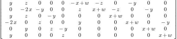

Example 10. Steine's Roman Surface . Then a matrix representation of is
Function: matrix_rep_surface(surface,varsur,varimplsur).
Mmx]
include "shape/matrixrepresentation/curvesurface.mmx"
Mmx]
R:=QQ['x,'y,'z,'w];
Mmx]
Steine:=[R<<"x^2+y^2+z^2",R<<"x*y",R<<"x*z",R<<"y*z"]
Mmx]
varimplsur:=[R<<"x",R<<"y",R<<"z",R<<"w"]
Mmx]
varsur:=[R<<"x",R<<"y",R<<"z"]
Mmx]
matrix_rep_surface(Steine,varsur,varimplsur)

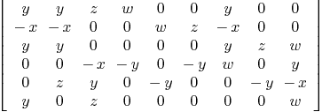

Example 11. A sphere :. Then a matrix representation of is
Mmx]
Sphere:=[R<<"x^2+y^2+z^2",R<<"2*x*z",R<<"2*x*y",R<<"x^2-y^2-z^2"]
Mmx]
matrix_rep_surface(Sphere,varsur,varimplsur)

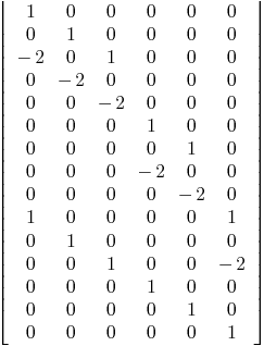

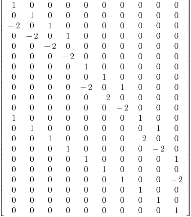

Example 13. M=.
Then and the generalized companion matrices of M are
Mmx]
include "shape/matrixrepresentation/pencilregular.mmx"
Mmx]
M:=matrix(polynomial(0,0,3),polynomial(0,3,0,-3);polynomial(1,1),
polynomial(1);polynomial(0,1,2), polynomial(0,1,1))
Mmx]
degree M
Mmx]
list_coefficients_matrix M
Mmx]
firstcompanionmatrix M
Mmx]
secondcompanionmatrix M
Mmx]

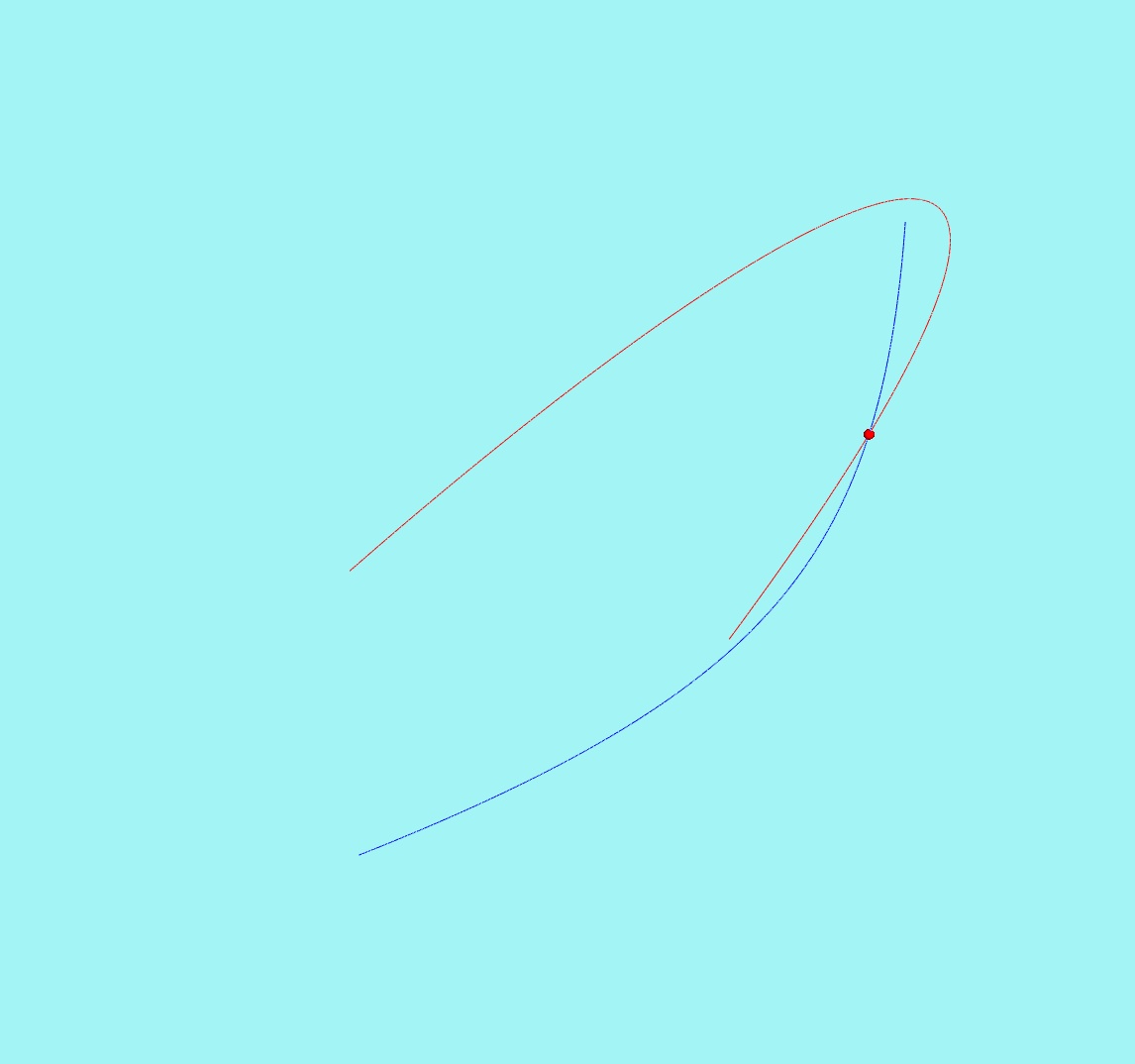

5.Parameterized curve/curve intersection
(1)
(2)
: Representation matrix of .
Representation matrix of :
As a consequence of the properties of a representation matrix, we have the following easy property.
Lemma 18. Let , then drops iff the point .
Hereafter, we give some example which are focussed on the intersection of the rational curves in the plane and the intersection of the rational curves in the space .
Function: intersection_curve_plane(curve1,curve2).
Function: intersection_curve_space(curve1,curve2).
Function: intersection_curve_plane_homogeneous(curve1,varcur1,curve2,varcur2).
Function: intersection_curve_space_homogeneous(curve1,varcur1,curve2,varcur2).

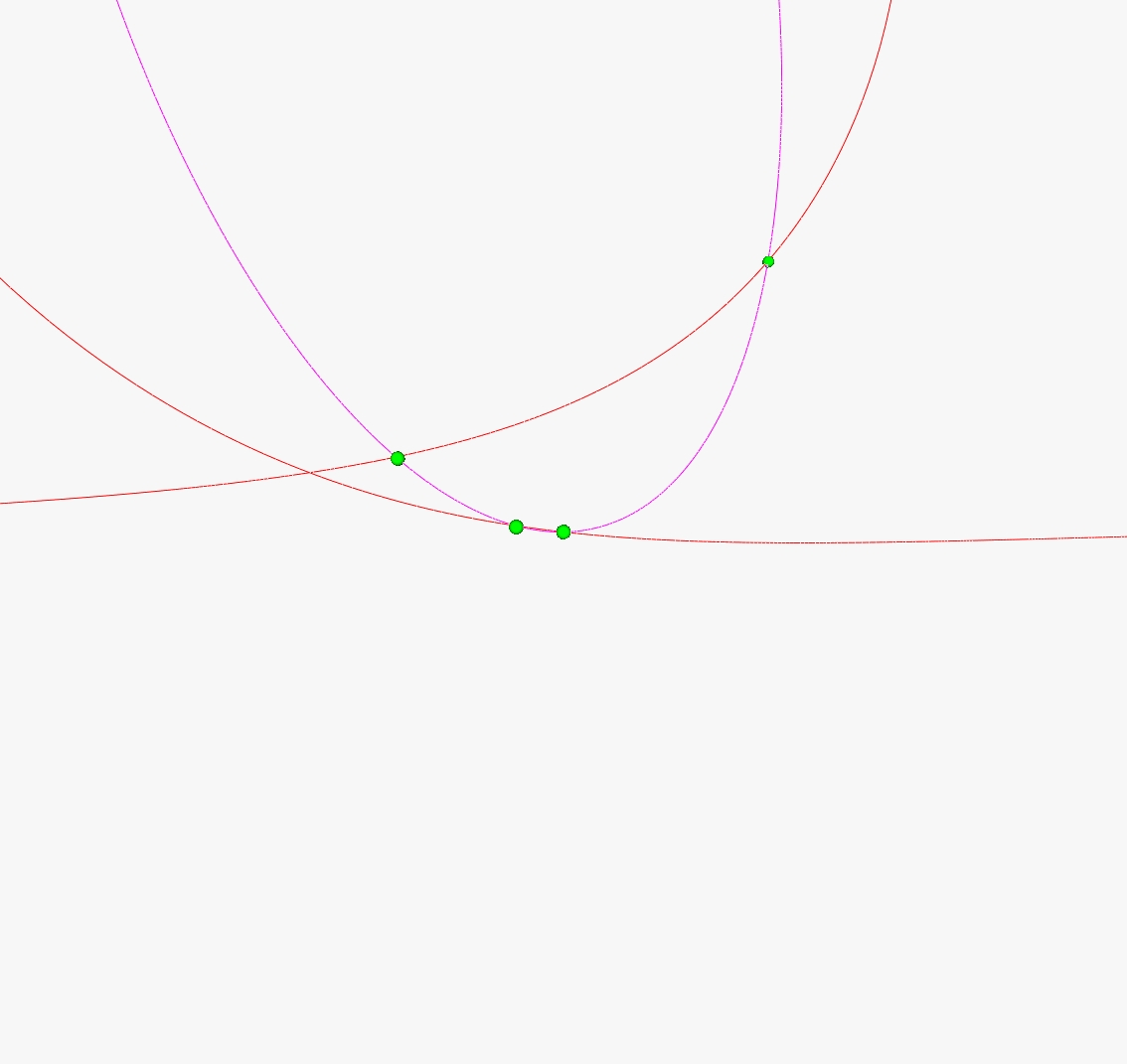

Example 19. :
are:
Mmx]
Mmx]
curve1:=[polynomial(0,0,3),polynomial(0,3,0,-3),
polynomial(1,1)]
Mmx]
curve2:=[polynomial(1),polynomial(0,1),polynomial(0,0,1)]
Mmx]
Mmx]
Figure 1. .

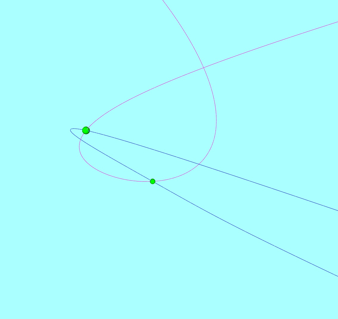

Example 20. .
are:
Mmx]
cur1:=[polynomial(-33,115/2,-49/2,0,1),polynomial(-36,61,-25,0,1),
polynomial(-8,27/2,-13/2,1),polynomial(1)]
Mmx]
cur2:=[polynomial(-3,17/2,-11/2,1),polynomial(-6,12,-6,1),polynomial
(-38,125/2,-51/2,0,1),polynomial(1)]
Mmx]
intersection_curve_space(cur1,cur2)
Mmx]
Figure 2. Four intersection points : (1,1,0),(0,2,1),(0,3,1) and (-308,-341,-363). The point (-308,-341,-363) doesn't appear in this picture.
Figure 3. The intersection point: (-308,-341,-363)

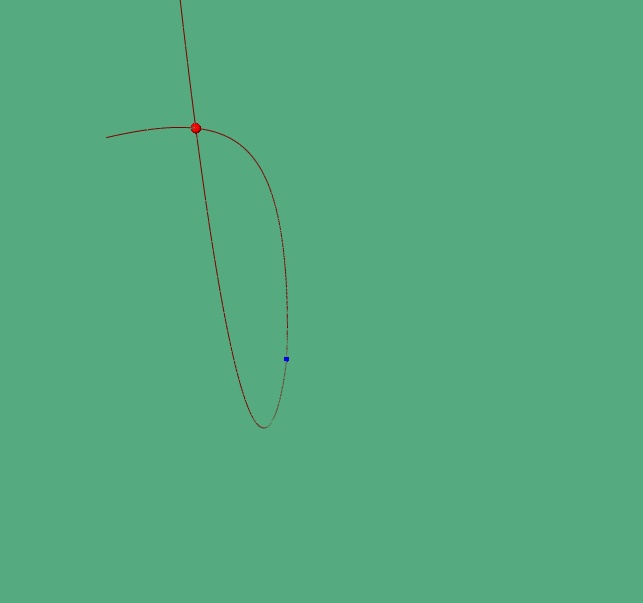

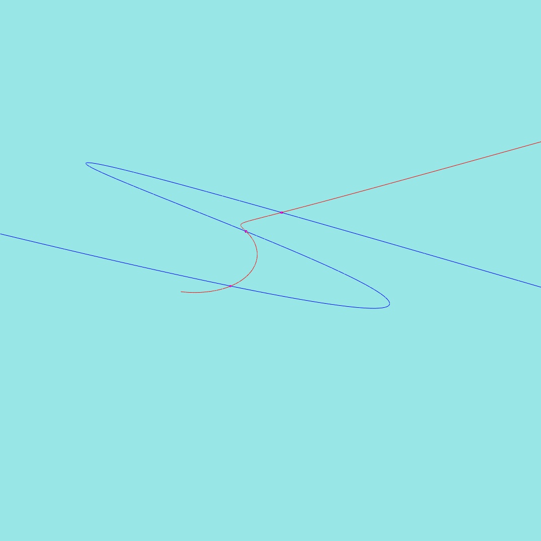

Example 21.
are:
Mmx]
Mmx]
cur1:=[QQ['x,'y]<<"x^3+3*x^2*y+2*x*y^2+y^3",QQ['x,'y]
<<"x^2*y+2*x*y^2+2*y^3",QQ['x,'y]<<"x*y^2+3*y^3", QQ['x,'y]<<"y^3"]
Mmx]
cur2:=[QQ['x,'y]<<"x^4-x*y^3+y^4",QQ['x,'y]<<"x*y^3+y^4",QQ['x,'y]<<"x*y^3+2*y^4",QQ['x,'y]<<"y^4"]
Mmx]
varcur:=[QQ['x,'y]<<"x",QQ['x,'y]<<"y"]
Mmx]
intersection_curve_space_homogeneous(cur1,varcur,cur2,varcur)
Mmx]
Figure 4. The intersection points in the affine space: (1,2,3) and (1,1,2).

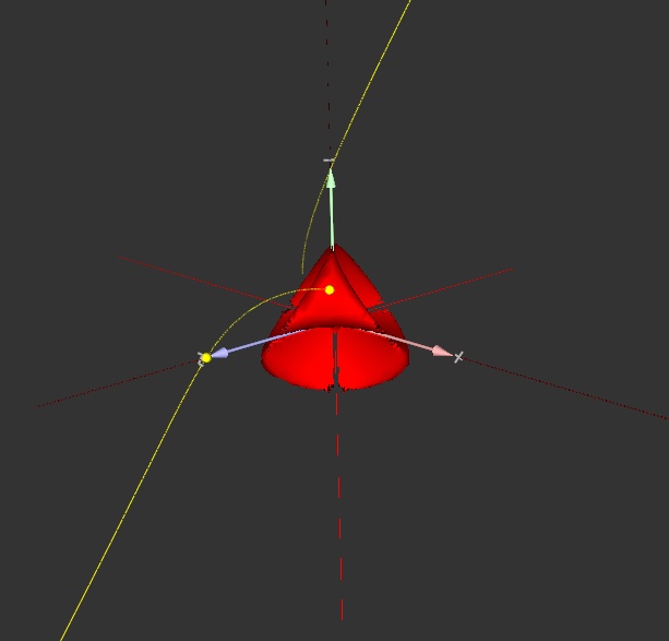

6.Parameterized curve/surface intersection
matrix representation of the surface .
M(s,t): matrix representation of :
and we have the following easy property:
Lemma 22. Let , then rank of drops iff .
Function: intersection_curve_surface_homogeneous(surface,varsur,curve,varcur)

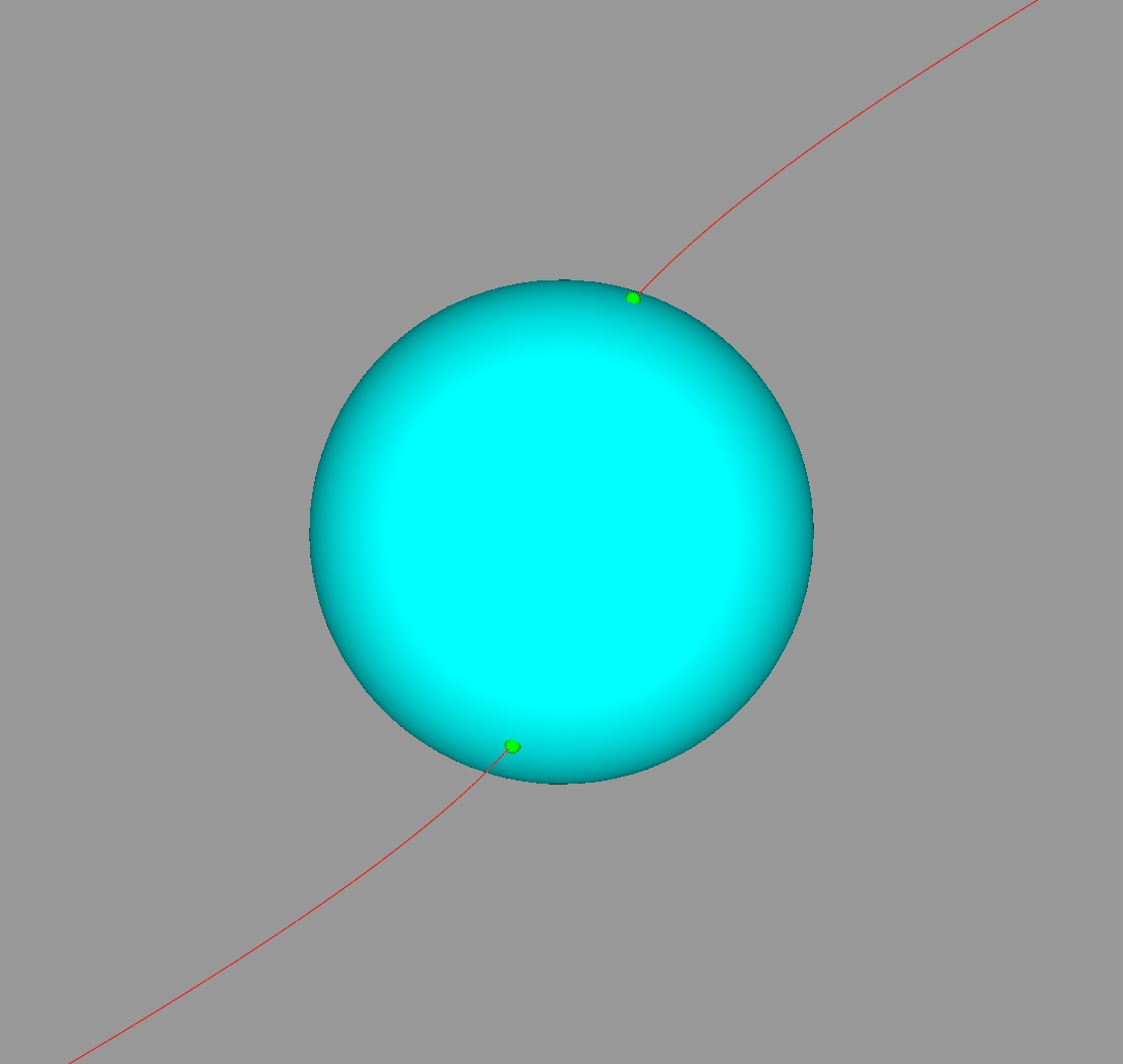

Example 23. Sphere .
Twisted cubic .
are:
Mmx]
Mmx]
R:=QQ['s,'t,'x,'y,'z]
Mmx]
sur:=[R<<"x^2+y^2+z^2",R<<"2*x*z",R<<"2*x*y",R<<"x^2-y^2-z^2"]
Mmx]
cur:=[R<<"t^3",R<<"s*t^2",R<<"s^2*t",R<<"s^3"]
Mmx]
Mmx]
varcur:=[R<<"s",R<<"t"]
Mmx]
intersection_curve_surface_homogeneous(sur,varsur,cur,varcur)
Mmx]
Figure 5. Two intersection points in the affine space : (-0.73735, 0.54368, -0.40089) and (0.73735, 0.54368, 0.40089)
Example 24. Steiner's Roman Surface
Then are:
Mmx]
Mmx]
steiner:=[R<<"x^2+y^2+z^2", R<<"y*z", R<<"x*z", R<<"x*y"]
Mmx]
varsteiner:=[R<<"x",R<<"y",R<<"z"]
Mmx]
cur:=[R<<"s^3+s*t^2+t^3",R<<"s^2*t",R<<"s*t^2", R<<"t^3"]
Mmx]
varcur:=[R<<"s", R<<"t"]
Mmx]
intersection_curve_surface_homogeneous(steiner,varsteiner,cur,varcur)
Mmx]
Figure 6. The intersection point in the affine space: (0,0,1), and (0,0,0).

Figure 7. P(2,7) of multiplicity 2 and Q(2,3) of multiplicity 3
