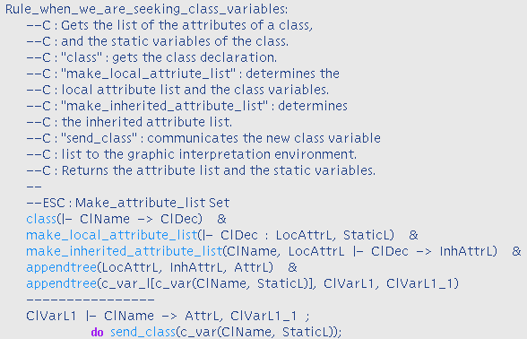

The semantics of inheritance and dynamic binding is expressed in Natural Semantics (200 rules). For example this next rule is dealing with the obtainment of the attribute list of a given type and of the associated static variables.

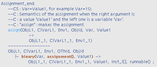

We present here the two main Typol rules defining the evaluation of the assignment expression.
This first rule concerns the case "Var = Value1" where Var is a simple variable. In this case, the "assign" predicate deals with the assigment.

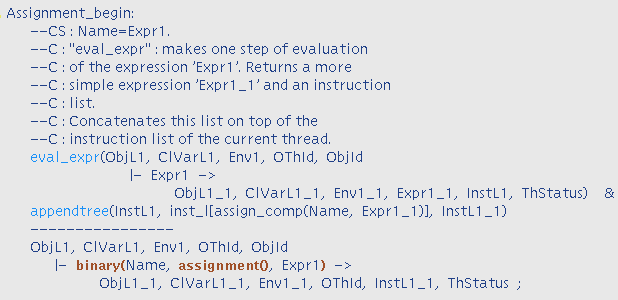

This second rule deals with the case "Name = Expr1". Here "Expr1" is evaluated in "Expr1_1" and, in the next step of execution the instruction to execute will be the first instruction of "InstL1". When this instruction list will be executed, the next instruction to execute will be the evaluation of the expression "Name = Expr1_1".
We need these two rules in order to simulate interleaving between several threads. The assignment is not an atomic statement so we need to foresee a possibility of interleaving during its execution.
