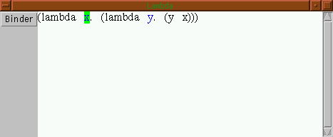

and we run it with the file ex1.lambda that contains a lambda term with some variables:
(lambda x . (lambda y . (y x)))
Running the command:
java lambda.test2 ex1.lambda
selecting the second occurrence of x and clicking on the button Binder gives the expected result:
window snapshot
